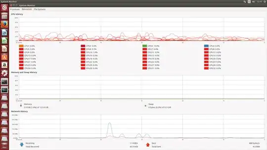

The System Monitor tool is showing me 32 CPUs when I'm expecting 56. Should I be concerned?
Screenshot of System Monitor:
As you can see, it shows 32 CPUs.

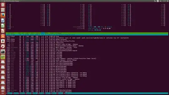

As you can see, according to lscpu, I should have 56 CPUs.
htop is also showing me 56 CPUs.
Screenshot of htop

  1. Your system configuration is probably fine. Gnome-system-monitor is simply reporting the wrong number.
  2. No need to worry.
  3. As already mentioned in a comment above, the “System” tab is gone in Ubuntu 14.04.
In More Detail
You have hit a hard upper CPU number limit that is set in libgtop (a library which is used by gnome-system-monitor). Quoting from the code:
/* Nobody should really be using more than 4 processors.
   Yes we are :)
   Nobody should really be using more than 32 processors.
#define GLIBTOP_NCPU        32
This limit has been increased to 1024 in more recent libgtop versions than the one shipped with Ubuntu 14.04.
Aside from being annoying to not see a good bunch of CPUs in gnome-system-monitor, this bug should be harmless. You might be able to fix it by installing a more recent version of libgtop. Alternatively, you could upgrade to a newer Ubuntu version. The question is whether the gnome-system-monitor annoyance is worth the hassle of upgrading or trying a more recent version of libgtop.
