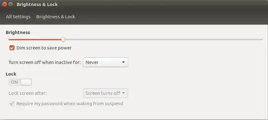

I was facing similar issue this answer solved my issue. Install Unity Tweak Tool and in System > Security all the options should be unticked. The Desktop Lock was ticked in my case uncheck this.
See this img:
If the above mentioned option is ticked then in System Settings > Brightness and Lock the lock option is disabled which causes all the problem.
See this img:
