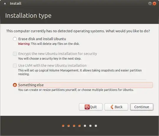

Actually, Yes. When installing, go into the advanced partition manager, selecting 'Something else' when installing. Advanced partiton Then, when choosing root partition,

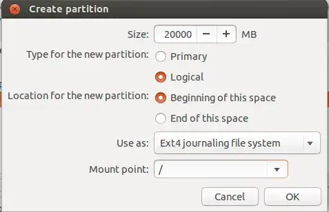

Make sure you choose the previous Ubuntu installation partition. partition
Select it as 'ext4 journaling file system'
Make sure your partition labeled windows is marked as 'not used'
