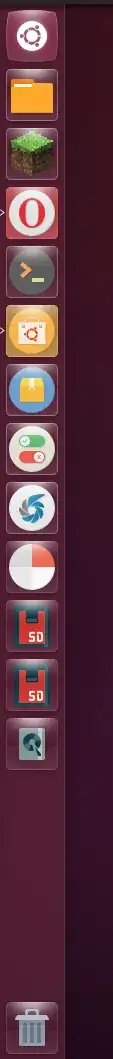

I have got here an installation of Unity and I am annoyed with the 3 disk icons in the Launcher right below the workspace switcher. Is there a way to prevent these icons from showing?
Those 3 icons right above the trash.

From Dash icon, it seems it's Ubuntu 12.04.
Kindly follow these instructions:
Install compizconfig-settings-manager if you haven't already.
sudo apt-get install compizconfig-settings-manager
Run CompizConfig Settings Manager and navigate to the Unity plugin.
In the Experimental Tab, change the Show Devices combobox to Never.
