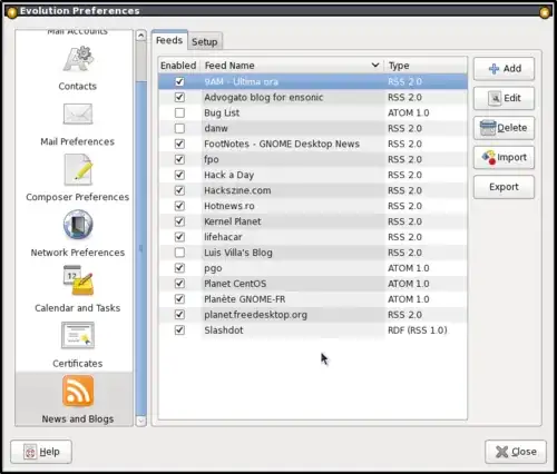

Adding RSS feeds to Evolution can be done by going to Edit->Preferences->News & Blogs
Or, press the shortcut Shift+Ctrl+s and scroll down to select News & Blogs.
Next, Select Add and paste the URL into the field provided.
A new folder called "News and Blogs" will be created in the "On This Computer" section of the Evolution folder tree where your subscription feeds will be updated.
