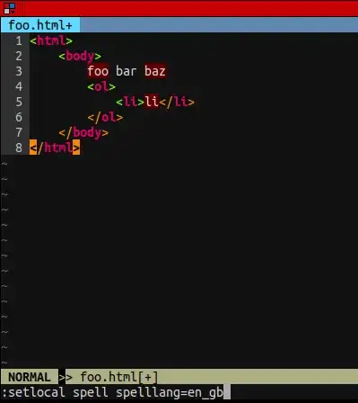

        Vim's spell checking is smart enough to distinguish between HTML tags and their contents:
Spell checking is not enabled by default, and can be enabled by:
:set spell
The documentation for spell checking in Vim can be browsed using :help spell.
If you have never use Vim before, it can be a bit ... daunting. First install a more full-featured version:
sudo apt-get install vim-gnome
Then run gvimtutor to learn the basics of Vim.
