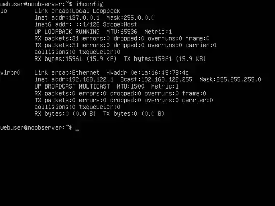

I can't connect to internet. I lost eth0.

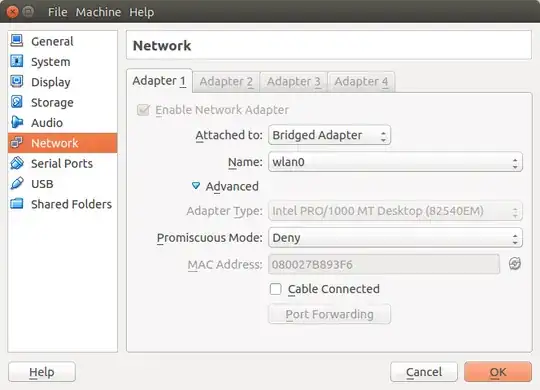

My VirtualBox network is Attached to : Bridged Adapter, Name : wlan0

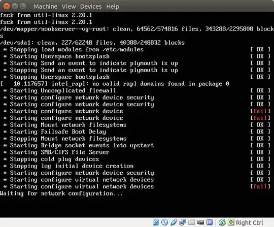

Network configuration fails at VM boot

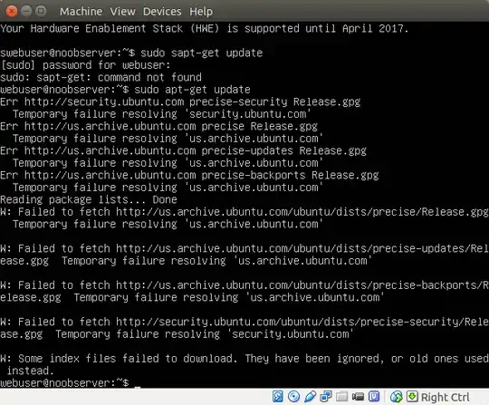

apt-get update is failing due to DNS resolution failure.

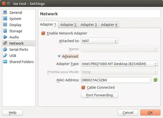

First I set the machine attached: NAT and started up the server the reload the network
sudo /etc/init.d/network reload
then I shut down the server and set the attached to bridge Adapter and started up the machine, and typed these commands:
sudo virsh net-destroy default
sudo virsh net-undefine default
sudo service libvirtd restart
sudo reboot
