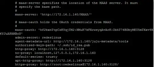

I am using Ubuntu 14.04 server, have MaaS as Juju environment. I was having some issues which my bootstrapped node couldn't access the charm store, so I installed the squid proxy server.

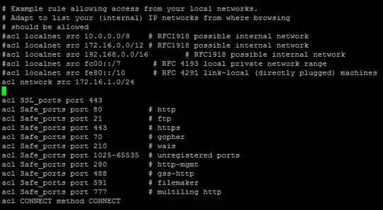

Here's what I did:
Default
Commented
Commented the http_access deny_all
Added http_access allow network
Added http_acces allow all
Added acl network src 172.16.1.0/24

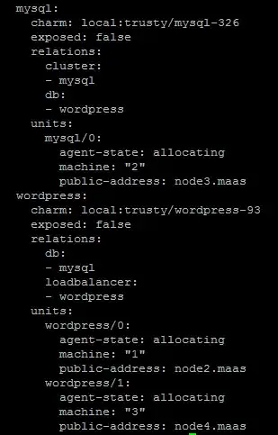

Juju status
The ~/.juju/environments.yaml file:
juju debug-log --replay :
I don't know why is not working, even the charms WordPress and MySQL are still allocating...
Any tips? Thanks in advance

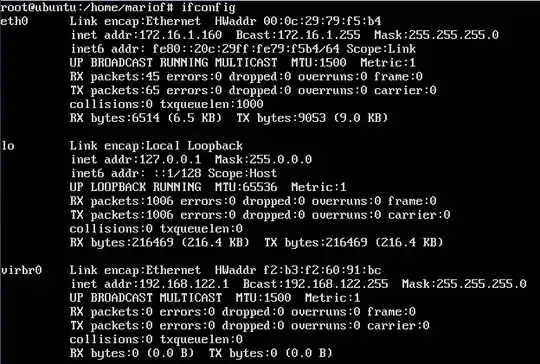

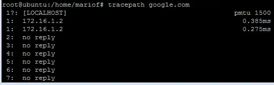

On the MaaS Server:
route -n
tracepath google.com
Now juju ssh 0:
route -n

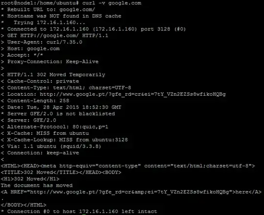

curl -v google.com
Information about my setup on MaaS Server:

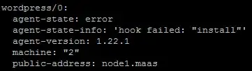

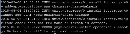

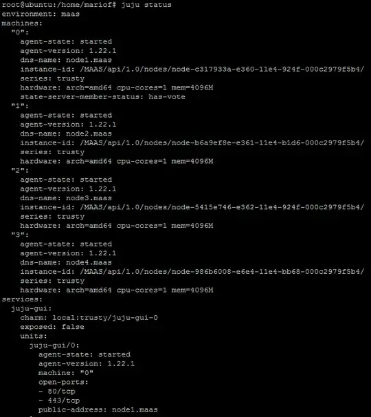

I re-bootstrapped my MaaS environment, deployed mysql+wordpress+relation and deployed juju gui, and this is my actual status, but my wordpress node can't seem to do: add-apt-repository ppa:charmers/charm-helpers despite having installed it on my server

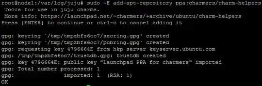

Testing add-apt-repository ppa:charmers/charm-helpers on my MaaS server:

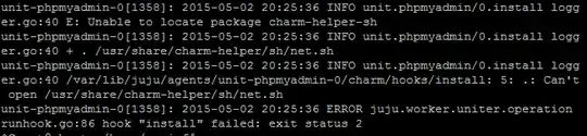

Testing add-apt-repository ppa:charmers/charm-helpers on the wordpress node ( hook failed install ):

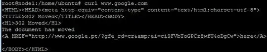

route -n
curl www.google.com

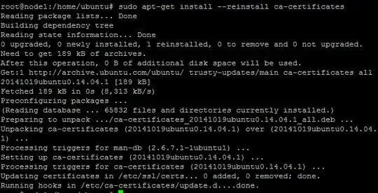

sudo apt-get install --reinstall ca-certificates
juju resolved --retry wordpress/0
juju resolved --retry phpmyadmin/0

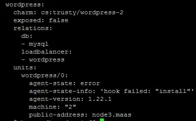

wordpress:
phpmyadmin:

But when I go to my MaaS server where juju is installed:
and so I went again to the node where wordpress is installed to check why is not working:
juju ssh 2
su
It works if I add export http_proxy=http://root:redeslinux@172.16.1.160:3128/ but when I close the wordpress node PuTTY, and open the MaaS server PuTTY and do juju resolved --retry wordpress/0 gives hook failed install.
What to do, to make export http_proxy=http://root:redeslinux@172.16.1.160:3128/ permanent in the wordpress node or similiar?

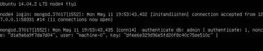

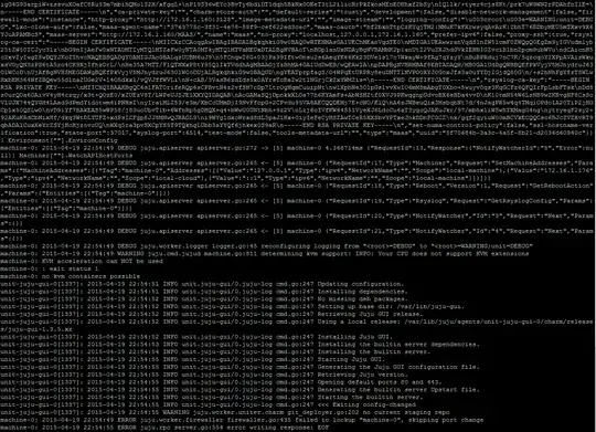

The bootstrapped node show some messages:
machine-0: 2015-05-11 20:13:30 ERROR juju.worker.firewaller firewaller.go:435 failed to lookup "machine-0", skipping port change machine-0: 2015-05-11 20:13:30 ERROR juju.worker runner.go:219 exited "firewaller": gomaasapi: got error back from server: 401 OK (Expired timestamp: given 1431375210 and now 1431382411 has a greater difference than threshold 300) machine-0: 2015-05-11 20:13:31 ERROR juju.provisioner provisioner.go:204 environ provisioner died: failed to process updated machines: failed to get all instances from broker: gomaasapi: got error back from server: 401 OK (Expired timestamp: given 1431375211 and now 1431382412 has a greater difference than threshold 300) machine-0: 2015-05-11 20:13:31 ERROR juju.worker runner.go:219 exited "environ-provisioner": failed to process updated machines: failed to get all instances from broker: gomaasapi: got error back from server: 401 OK (Expired timestamp: given 1431375211 and now 1431382412 has a greater difference than threshold 300) machine-0: 2015-05-11 20:13:33 ERROR juju.worker runner.go:219 exited "firewaller": gomaasapi: got error back from server: 401 OK (Expired timestamp: given 1431375213 and now 1431382414 has a greater difference than threshold 300)
How to fix this?

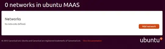

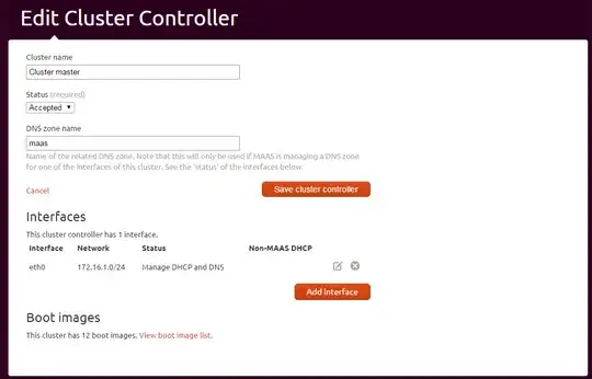

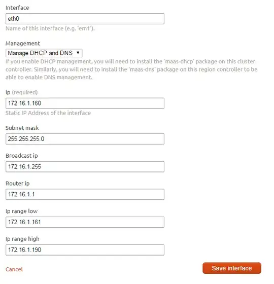

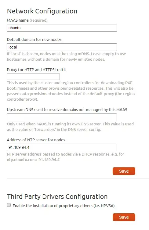

I assume by charm store you are referring to the website? I'm almost sure that Squid is overkill.
I see that machine 0 uses your proxy successfully. I can also see that the default route of machine 0 is 172.16.1.1, but the default route of the MAAS host is 172.16.1.2. It is set up incorrectly in the MAAS web interface, as you show in your screenshot. Change the "Router" configuration in the MAAS DHCP website to 172.16.1.2, and re-try

I had same error check your time zone and set all to UTC, after installation you can return it back in any local time zone
