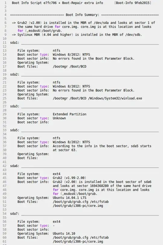

I have Windows 8.1, Ubuntu 14.04.2 and Ubuntu 14.10 on my machine. After installing the last, the GRUB is not showing the first two Operation Systems. I have try to fix this using Boot Repair but the Recommended Repair option did not fix the issue.
I have generated a Boot-info Summary since using advanced options of Boot Repair without understanding them could cause more problems.
Here is the full report and here is the initial part of it:
