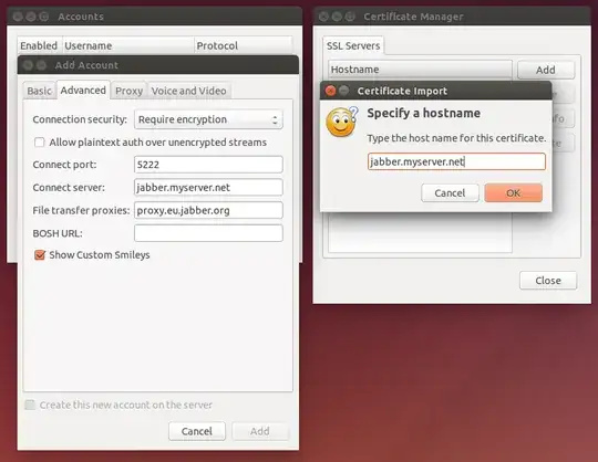

It seems to be important that the name you enter when importing the certificate via ToolsCertificates matches the connect server in the XMPP account configuration. This is the only way I was able to get it to work for the same error.
Connect server and certificate hostname should match

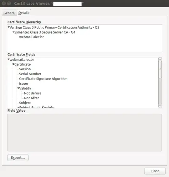

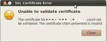

Another workaround is to import the name of the server specified in the error like myserver.chat.com. For example:
  1. Open the Firefox browser and put the URL: HTTPS://mysever.chat.com, you'll get an error:
    Invalid certificate error
  2. Select, Advanced option then Add Exception. A popup for the certificate will open.
  3. Then click Advanced -> Details -> Export
    Certificate Viewer
  4. Save the certificate somewhere
  5. Open Pidgin, go to Tools -> Certificates -> Add Now save the certificate with the same common name as the error in the beginning.
Finally, try to reconnect.
