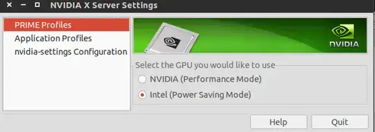

If you have nvidia prime installed just go to nvidia x server settings and choose it in prime profile (you need to relog to apply the changes). Nvidia prime
To install prime:

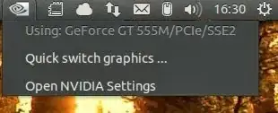

You can also install prime-indicator for easier switching. Prime indicator
sudo add-apt-repository ppa:nilarimogard/webupd8
sudo apt-get update
sudo apt-get install prime-indicator
