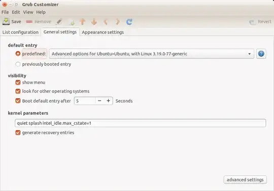

Boot up the machine, and after the BIOS screen, hold down the left Shift key (if a boot loader does not show up by itself). Then select 'advanced options for Ubuntu' and select the working kernel and press enter.
Then you can edit grub itself and make that kernel as default. If you are not 100% comfortable editing the configuration file /etc/default/grub, you can use grub-customizer
sudo add-apt-repository ppa:danielrichter2007/grub-customizer
sudo apt-get update
sudo apt-get install grub-customizer
grub-customizer &> /dev/null &  # to start it in the background
Go to the tab General Settings and select from 'default entry' whichever kernel version is your preferred default (see snapshot). You may also move working the kernel entries up and down in the List Configuration tab if you want, but that's mainly presentational.
Sceenshot from Grub Configuration 5.0.6
