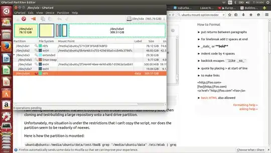

ubuntu@ubuntu:/media/ubuntu/data/test/0ad/build/workspaces$ sudo file -sL /dev/sda4
/dev/sda4: x86 boot sector
According to GParted, this is a primary ntfs partition. I have a Windown 7 on another partition and an Ubuntu on another set of partitions:
