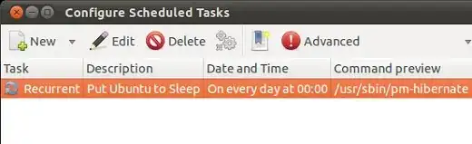

Use gnome-schedule
It's intuitive, and it's easier to launch graphical applications from (doing that via cron requires some extra work) - just don't forget to mark the command as an X application one in the task configuration.
Homepage: http://gnome-schedule.sourceforge.net/
Sample use: http://www.liberiangeek.net/2011/04/schedule-a-job-to-automatically-put-ubuntu-into-sleep-or-hibernation-mode/
