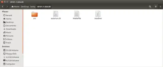

Download and install the LINUX driver for kernel 3.x and 2.6.x and 2.4.x found here
Make a temp folder on your desktop and extract the content into it. You'll see this:realtek
Open a terminal with CtrlAltT
change to the directory of the content. In my case.
cd ~/Desktop/temp/r8101-1.026.00/

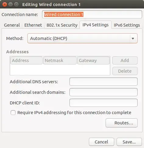

then issue the command sudo ./autorun.sh This will install the driver that supports your ethernet chipset.
Open network connections, choose the wired connection and chooseeth1 edit and insure your settings match the above.
