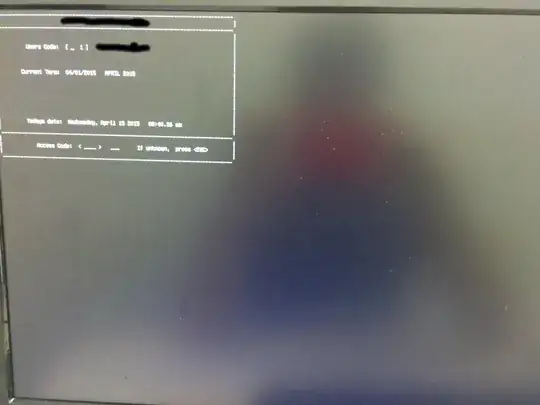

I'm having issues with controlling the size of a text-mode program. This is a database program (Dataflex) that I recently had working on Windows 98 DOS mode and now am moving it to Linux.
I have tried altering the resolution of console-mode using How do I increase console-mode resolution?, but that has no affect on the program size.
I have also tried changing the columns and rows variables which doesn't work. Also this which broke my Grub entirely.
Currently the program takes up the top left 1/4 of my screen. It looks tiny. I'd attach a picture but I don't have the 10 reputation points yet.
Has anyone else solved issues on controlling the size of a text-mode program? Or know of any solution. Any help would be much appreciated.
Thanks.
Edit: I have 10 points now so I'll attach a picture. I had to take it with my phone, since I don't have access to terminal while using the program. I can interact with the program just fine, but it's just the size that's an issue.
Image of program size

The dataflex KB should provide the instructions that you require. If they don't work it's a support issue with DataAccess. TERMINFO must be set in addition to ROWS and COLS.
