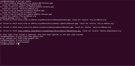

I am using the Beaglebone Black for the first time. It has the Debian 7.4 OS and I'm using Ubunbtu 14.04 installed in Virtualbox. I'm trying to install Python IO libraries but I'm getting the Can't resolve host name error. Pinging anything is giving the connect: Network is unreachable error. Here is the screenshot:
Result of apt-get update and ping

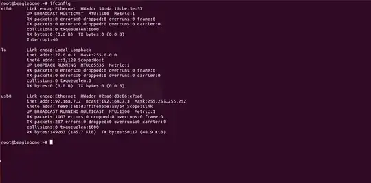

ifconfig:
result of ifconfig

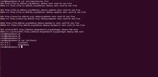

sources.list and hosts:
result of sources.list and hosts

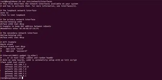

/etc/network/interfaces:
where 192.168.1.1 is the IP address of my router and 192.168.0.1 is the IP address of my modem (ref: the answer here)

I don't see that you are connecting your BBB(Beaglebone Black) to the internet "eth0" card is provided with a dhcp client by default.
The "usb0" card is a virtual card that help you to connect your BBB to a PC with any OS, you can allways connect your BB to windows after installing drivers and you can simply use putty to reach the terminal of BBB, if your are sure about using Ubuntu you can install it into your PC or you should connect your BBB to the internet using Ethernet, also you can use any standard Wifi card to make BBB online.
