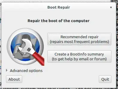

You can install boot-repair. And set the timeout through advanced settings in boot-repair.
Click on the Advanced option on boot-repair Boot-repair starting menu

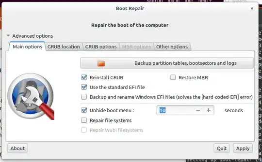

Now change the Unhide boot menu : 10 seconds to whatever time you want Advanced boot-repair
And click apply. If you wanted to install boot-repair checkout this link Installing Boot-repair
