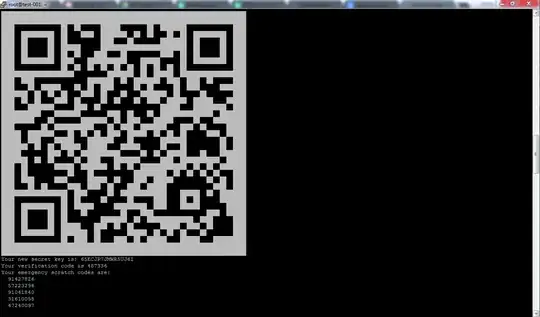

  7. After that it will show you the QR code and Emergency Scratch Codes and few other details. Out put should look like below given image:

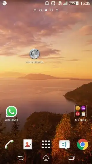

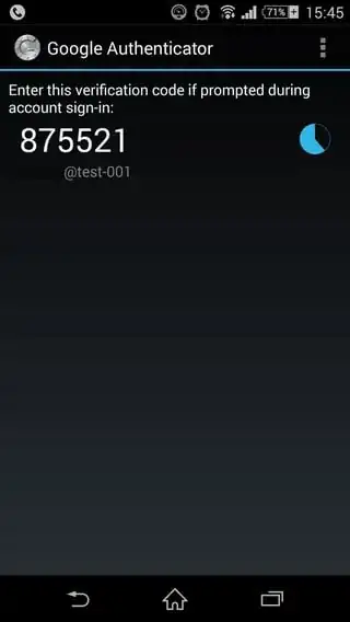

  8. Now you need to use your Android / Apple / Blackberry phone to download & install the Google Authenticator Application from the respective market places for example Google play store. which will generate code for you to login.
    Below are the screenshot of the application Icon and application taken from application Android phone.
  9. Start the application on your phone and scan the QR Code or else use the secret key and the verification code given below the QR code on the system, which you can also see in the first screenshot above.
  10. Once all of this is done it is very important to note down and save your emergency scratch codes on a safe place, as those are the codes which can help you in case you get locked out somehow.

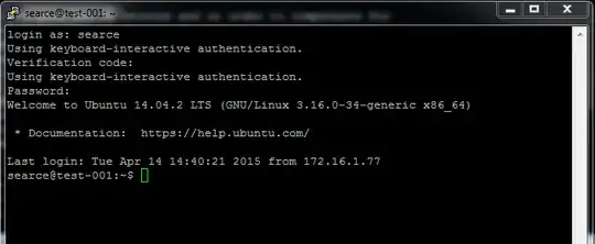

Now just take a ssh session for the user you have set it up for and it will first ask you for a verification code which you can enter from your mobile and then it will ask for a user password.
