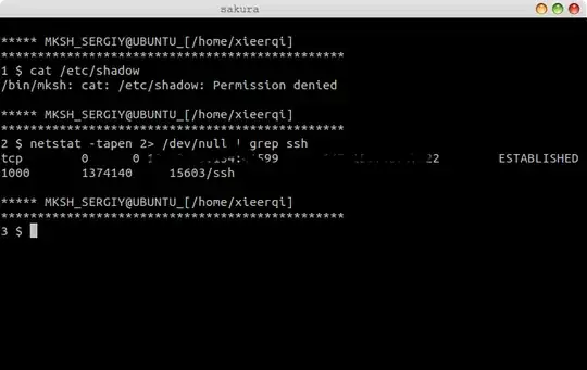

The line is bellogs to error output, i.e. sterr. You could get rid of it with
netstat -tapen 2> /dev/null | grep ssh
For reference check this
As properly noted by heemayl , without sudo, netstat won't report that connection is established by the ssh server, only if it's established by ssh client.
Of course, you can still determine it by port number or using who -a utility, which will show logins and address, but it's not a guarantee somebody isn't logged in via telnet or remote desktop application.
