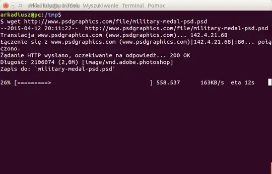

Some programs are able to amend console output, wget easily comes to mind.
How can I do that in pure Python? I know IPython has clear_output(). I tried that but even that does not work. And I would prefer pure Python.
