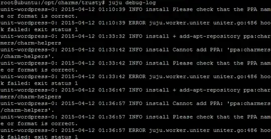

and then the error, after the pxe boot:
How do I solve this issue? Thanks in advance!

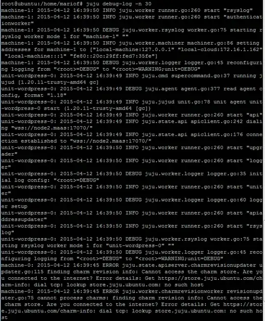

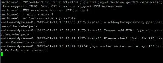

I suspect your MAAS node cannot reach out to the internet to install the necessary software. The charm-helpers PPA is being used by the node, not your local machine.
