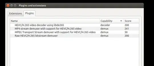

I have a HEVC (x.265) video. I am trying to play it in latest VLC (Rincewind 2.1.6) in Ubuntu 14.04. I have already installed VLC plugin for HEVC. Here is the screenshot: enter image description here

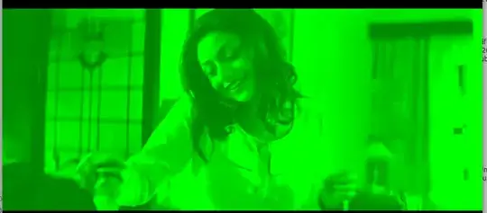

However, when I try to play video, a green layer is coming over the video. Here's a screenshot: enter image description here
I tried with lots of other players like DragonPlayer, SMPlayer. All of these have problems. So, I suppose this is a problem with Ubuntu itself. Any solution?
Update: I updated to 2.2.1 . Still, the problem persists.
