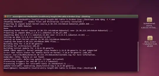

m trying to install wifi driver for : Broadcom Corporation BCM4360 802.11ac Wireless Network Adapter [14e4:43a0] (rev 03) in my Macbook pro, but after following this answer (Ubuntu can't detect wifi networks on macbookpro 13.3) i'm facing this problem ERROR (dkms apport) kernel not supported as you can see in this picture:

Download from a mirror site: http://packages.ubuntu.com/wily/amd64/bcmwl-kernel-source/download and install, this new version is compatible with the 3.16 kernel
