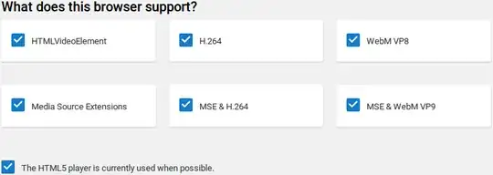

Restart Firefox and go to https://www.youtube.com/html5. You should see something like the following image:
Screenshot of HTML5 support in YouTube
This solution worked for me and I didn't have to install any third-party software such as FlashPlayer or Firefox Extension. I've came up with this solution by looking at the Arch Linux Wiki > Firefox Tweaks > Enable Additional Media Codecs.

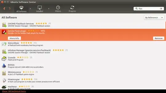

My browser is Firefox 37.0.1 and I'm using Ubuntu 14.04 LTS I have numerous quality options available ranging from 144p all the way up to 1080p in the browser. All I've ever needed to do is install Adobe Flash plugin from the software center here:
flashplugininstaller
