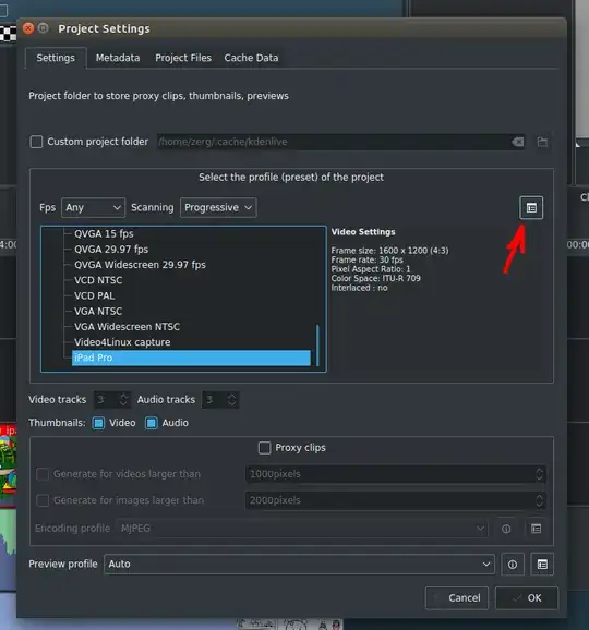

  1. Start a new project with the desired crop size.

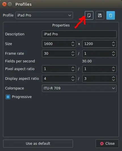

    If no profile available with required size you should create a new project profile by clicking on Manage project profiles button. screenshot
    Then click on create new profile.
    screenshot
    Change the profile settings as required in your case make it 900x690.

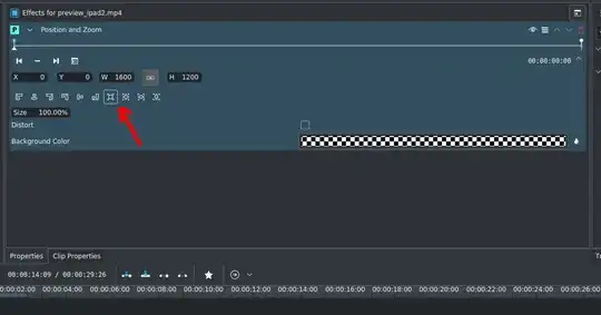

  3. Add Position and Zoom effect to your clip.
  4. Click on adjust to original size in the effect settings.
    screenshot
  5. Change the X and Y to adjust the position of the cropped region as desired.

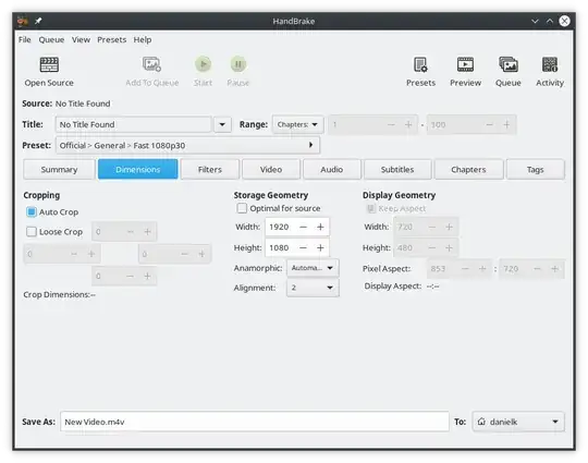

Handbrake
I would recommend using another program, Handbrake. Use the Loose Crop option, then switch back to the Summary tab to see a visual representation of the crop effect. I found it rendered faster than Kdenlive using the crop effect as well.
screenshot

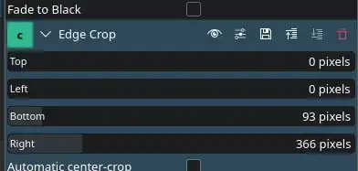

Kdenlive
Install Kdenlive 23.08.1 with Flatpak, then:
  1. Add clip to project bin and drag & drop it to the video track.
  2. On Effects tab, search for Edge Crop
    screenshot
  3. Drag & drop it to video section to crop.
    screenshot
  4. On the left, on the Effect/Composition stack, tune the crop parameters, checking the results preview on the project monitor (by default in the upper right corner).
    screenshot
Done.
From manual:
Warning
As of this writing and in version 23.04 this effect still behaves strangely. The parameter values seem to interfere with each other and it is not possible to have all four sides being cropped. It is either top/bottom or left/right and only the last value entered is applied (and then on both sides). Until this is fixed it is recommended to use the Crop, Scale and Tilt effect.
Based on this idea.

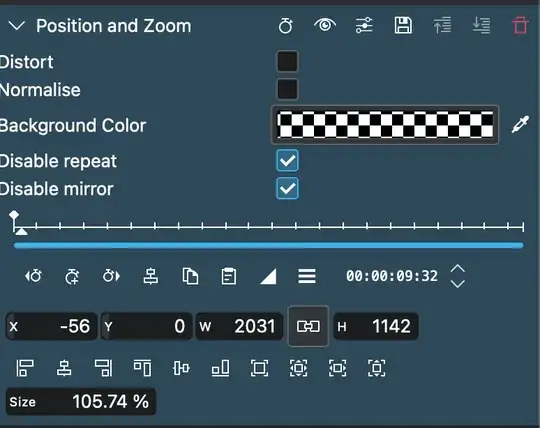

To crop a video without black sides, in Kdenlive 24.02.1 I used effect "Transform, Distort and Perspective -> Position and Zoom": enter image description here
So you essentially zoom + shift until you get only the part of the image you need in the existing window size.
