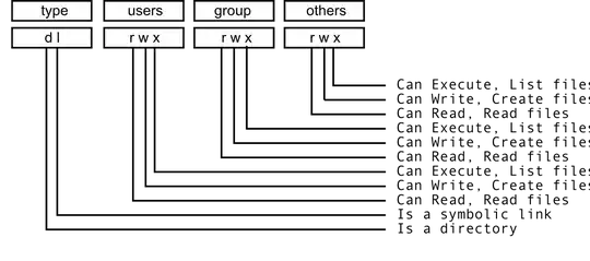

You can learn more about permission numbers and what they mean from this image
