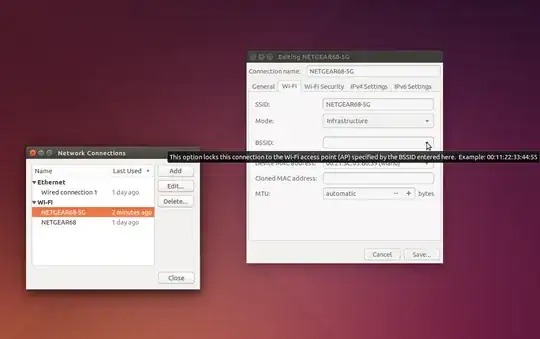

With network-manager, you can enforce a specific access point BSSID via the connection editor Edit... then select the Wifi tab and enter the BSSID:. Obviously this solution requires that your users don't have sufficient privileges to subsequently modify network-manager wireless settings.
nm-connection-editor wifi tab
