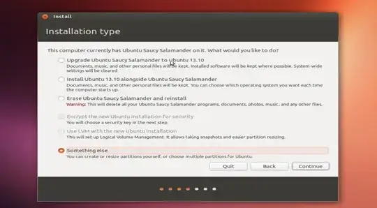

At some point during the installation process you will come to this window, where you will be prompted to choose installation type:
Install
Normally if you are a new user you should select Erase everything and install Ubuntu. This will create the needed partitions automatically.
But since you want more advanced partitioning you want to choose the last option - Something else.

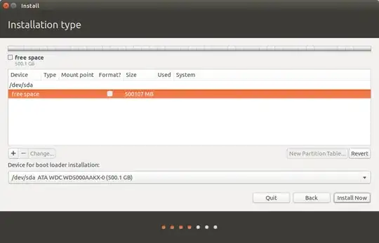

After you choose it and click next you will see the partitioning window. If you previously had some OS on the hard disk you will see several partitions present. You click on each of them and click - sign to delete them, until you have only free space left like in the image note that deleting partitions will erase all information on your HDD!

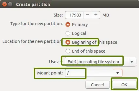

Now you need to create the partition for the root filesystem. Click on the free space then click + and select:
Root partition
For size you can choose between 20 000 MB (20 GB) and 80 000 MB (80 GB) since you have 1000 GB HDD. This way you will have all other space left for your home folder and files.
