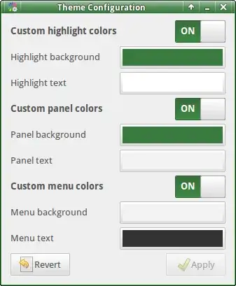

I recommend going to Window Manager > Style tab to try different options. Also customize in Appearance > Style and Icons tabs. Playing with those three options can offer a lot of possibilities. I really like setting a custom color. On Xubuntu 14.04, I have Daloa as the Window Manager, Orion as my theme (Style tab in Appearance), and elementary Xfce darker as my Icons. Then in Theme Configuration, gtk-theme-config, I have custom colors set. With this setup I have nice green accents throughout my system.
gtk-theme-config settings
If you have Xfce 4.12, Orion is not installed there, but there I use Greybird theme. (This is on my Fedora Xfce install.) Greybird also does a nice job of populating my theme color throughout the system.
