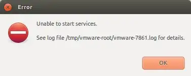

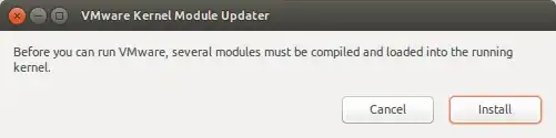

Post-installation, when I tried to launch VMWare Player, but got this prompt: enter image description here

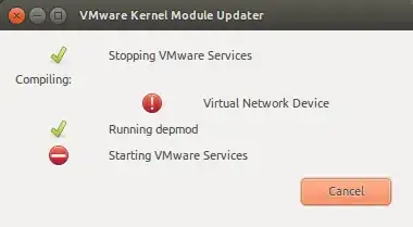

Proceeding lead to these error screens:

I then repackaged and tried to start VMWare Player, but it still would not start, with the same error as before. Here are the contents of the log file that it points me to.
