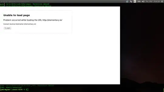

This browser window showing http://elementary.io/ appears after I installed then uninstalled the Pantheon environment: enter image description here Originally this occurred after (and possibly before) ppa-purging the PPA only when not connected to the internet - a window without a title that the window manager would ignore would appear, then dissapear. The grep process in the background was me searching the root of the system for clues to the problem - I found that some settings in gconf had been left which were causing a additional issue with the elementary theme set as default, which I then apt-get auotremoved)

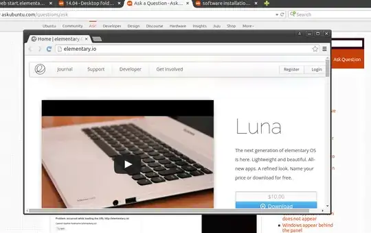

enter image description here After apt-get autoremoving the elementary packages it opens properly in a web browser
It seems to appear randomly (in a random web browser - I have Firefox, Chromium and Chrome installed - this started happening before installing Chrome), and after unlocking the screen, connecting to the internet etc. I think the URL it is pointing to is http://start.elementaryos.org which then redirects to http://elementary.io/

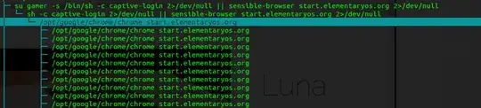

EDIT: By looking at htop I have found that the process is started as root the run as the active user (gamer) using su:
here

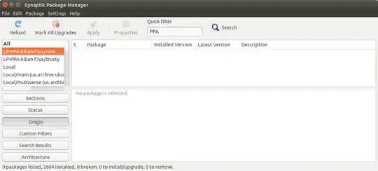

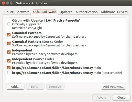

ppa-purge is unneffective with that ppa, (elementary-os/daily) & the same with autoremove.
Open Synaptic, PPA1
click Settings, Repositories
PPA2
Click Add and add back the ppa you used previously & update sources.
Click the Reload button in the upper left corner, then Origin. Click on the entry for that ppa/now similar (entry highlighted above). With shift+click highlight all the packages & mark for removal, and remove them.
Then remove the PPA from your software sources Under Settings, Repositories.

The clue here is "captive-login" in your last screenshot. This is a new feature [1] in Elementary OS which seeks to make connecting to the Internet seamless when behind captive portals (hence the name). It is similar in nature to features on mobile platforms like iOS and Android. When on a restricted connection such as hotel or airport wifi a check is made to see if the computer can reach the 'real' Internet, and not the blocked off bit you have to sign into, in order to gain access.
So to me this just looks like a remnant of that feature kicking around, and needs removal.
