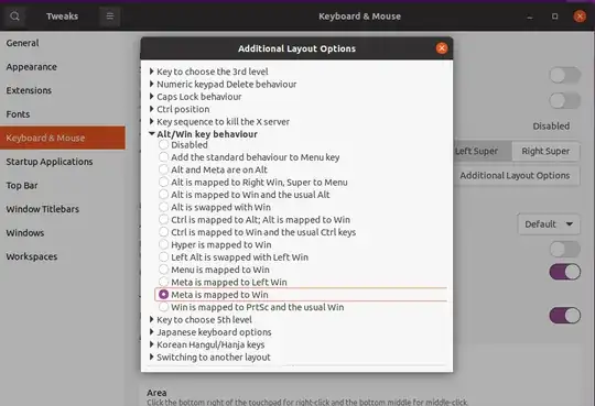

For Ubuntu 20.04, you should relace the command (aka. Windows/ Win) key with the meta key.
- Run
sudo apt install gnome-tweaks - Run
gnome-tweaks - Click
Keyboard & Mouse>Additional Layout Options>Expand Alt/Win key behaviour>Select "Meta is mapped to Win" (2nd last in list)
