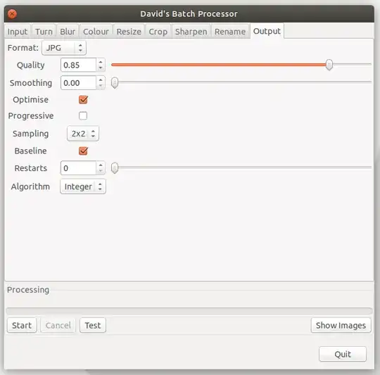

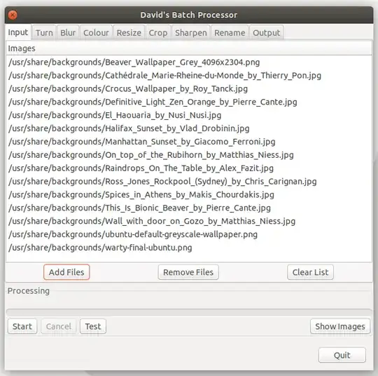

The GIMP GUI Solution Using a Batch Process Plugin
Works in Ubuntu 18.04 using GIMP 2.8
Batch Processor Input dialog window
David's Batch Processor input dialog window
Batch Processor output dialog window
Batch Processor Output Dialog Window
Installation Instructions
  1. Download the current plugin file from DBP - David's Batch Processor homepage to your desktop. For Ubuntu 18.04 running Gimp 2. 8 the file that worked for me was dbpSrc-1-1-9.tgz.

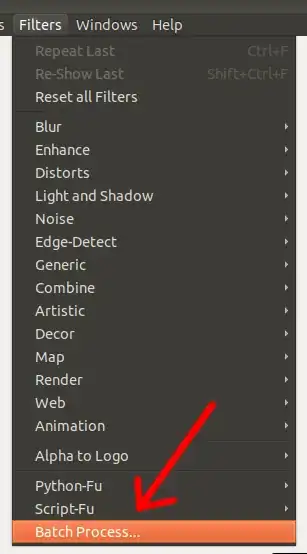

  8. Start GIMP and you will find the plugin under Menu > Filters > Batch Process
    GIMP Batch Process.. Menu Path
