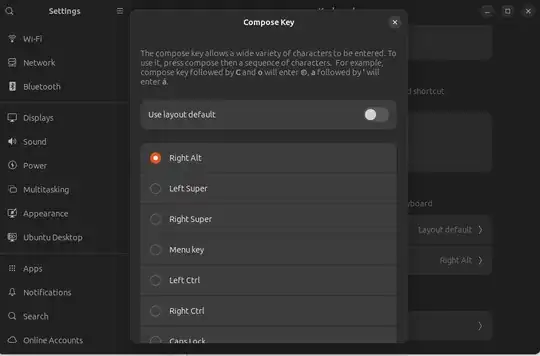

By using a Compose key (Right Alt or any other), without need of changing English as the input language (also available for Chinese or for Intelligent Pinyin in "英" mode)
    Right Alt + - + [a] = ā
Right Alt + ' + [a] = á
Right Alt + c + [a] = ǎ
Right Alt + ` + [a] = à
In order to activate the Compose key, go to: Settings -> Keyboard -> Compose Key -> Right Alt
State for Ubuntu 20.04.1 LTS

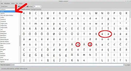

  • If you need something quickly: use the Character map:
    $ /usr/bin/charmap
    After opening it, select the Latin charmap, there you will have all the possible pinyin tones for each vocal (from 1 to 4)
    pinyin in ubuntu charmap
