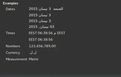

I'm using Ubuntu 14.04 LTS, gnome shell version 3.10.4. According to the settings, Ubuntu identifies the Arabic language (Lebanon) correctly:
Examples

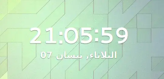

And the really interesting thing is, the lock screen does not have this problem.
Lock screen awesomeness
