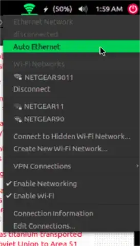

Plug the ethernet cable in. Click on the network-manager icon on your desktop panel to open the dropdown menu. Then, click on "Auto eth0"
If you see some message similar to "device is not managed" or "device is managed" please let me know and I'll post instructions on how to get around that.

Finally suspected the Ethernet port not working,and at, system setting / network showed wired unplugged. I ordered from ebay "USB to Ethernet connector" and soonest i connected, Ethernet became live.
