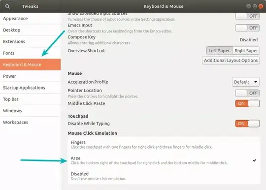

On Ubuntu 20.04 there is no /usr/share/X11/xorg.conf.d/50-synaptics.conf. Instead you can use GNOME Tweak tool. Install it with sudo apt install gnome-tweak-tool and then you can switch the mouse touchpad mode:
Selecting the option "Fingers" worked for me. Then right clicking with one tap is disabled but can still be done with tapping with 2 fingers.
