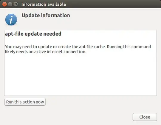

I was following these instructions and I have installed apt-file along with some other packages using:
sudo apt-get install gnupg pbuilder ubuntu-dev-tools bzr-builddeb apt-file
And now every time I startup my computer I get this notice:
apt-file update needed notice
