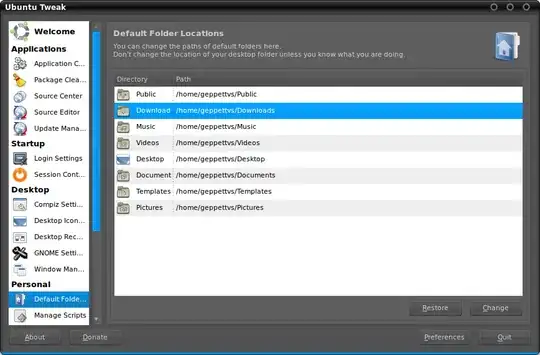

Ubuntu Tweak can be useful for you this time, but includes the install of the Ubuntu Tweak software, whose intuitive GUI will guide you on this and some other useful processes.
When installed, simply choose Ubuntu Tweak from within the System Tools sub-menu in the main menu. After which you can go to the "Personal" section in the sidebar and look inside "Default folders", where you can choose which will be your default folder for Downloads, Documents, Desktop, etc.
I hope this help you.

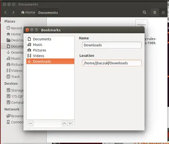

In Nautilus try Bookmarks > Bookmarks. You can edit the locations of the bookmarked folders.enter image description here
