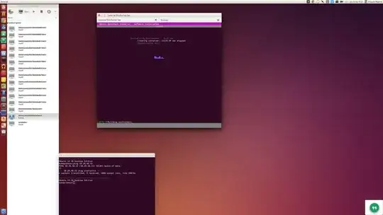

I've decided, as suggested us by dpb, to try to use the single machine option of openstack-install and testing openstack on our host. During the install I've not received any error, but it took 3h to run the installer and it continued to stay on "Creating Container:", as reported on this image:

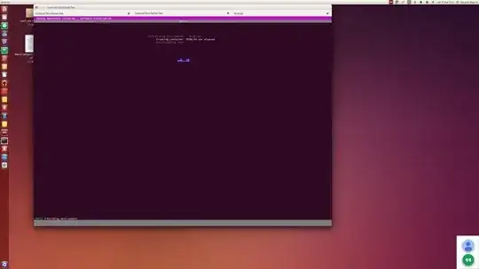

then
it remains in this status for long time....
after 3hr the situation is invariable

If that screenshot is any indication of the Distro you're running (Utopic) there is a known bug with apparmor that causes the single installer to fail
https://github.com/Ubuntu-Solutions-Engineering/openstack-installer/issues/470
The relevant launchpad bug:
https://bugs.launchpad.net/apparmor/+bug/1408833
You'll want to upgrade your kernel from that proposed pocket and report to our github bug if that fixes the installer issue.
