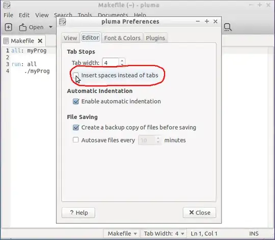

You can use any text editor for this, but the recipe for a rule--the commands listed under it that will be run to make its target--must must be indented with tabs rather than spaces.3 So if your text editor is currently configured to indent with spaces when you press Tab, you should change this.
For example, in Gedit or Pluma, you would go into Edit > Preferences, click the Editor tab, and ensure Insert spaces instead of tabs is unchecked:
Screenshot showing the Preferences dialog box in Pluma--whose interface is essentially the same as in Gedit--indicating the location of the Insert spaces instead of tabs checkbox near the top of the Editor tab
Many editors default to indenting with tabs and not spaces, so if you haven't changed this setting before, it may already be set correctly for makefiles.
