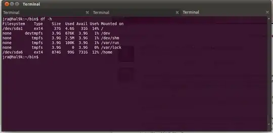

From a Terminal prompt:
df -h
You should have a screen similiar to the one attached which should give you the mount point of the USB device.
