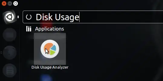

Open the Unity dash by clicking the Ubuntu logo with the swirly things:
or by pressing the Windows/Super key.
Once the dash is open, just type in Disk Usage and select Disk Usage Analyzer:
Note, your icon will look a little different - I've got the Numix Circle icon theme. Just click on the application titled Disk Usage Analyzer.

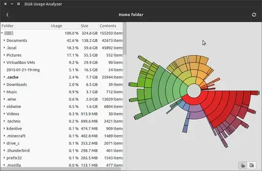

Once it's open, you should see a window that looks similar to this one:
It lists all files & folders on the left from largest to smallest, as well as a graphical visualization of it on the right.
Have a poke around in this tool, it's very useful for finding stuff that's taking up space.
