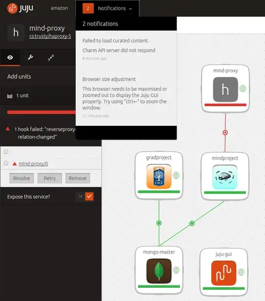

After juju add-relation mindproject:website mind-proxy:reverseproxy the Haproxy charm fails reverseproxy-relation-changed hook with this log:

2015-03-24 20:17:32 ERROR juju.worker.uniter uniter.go:486 hook failed: exit status 1
failed-hook
