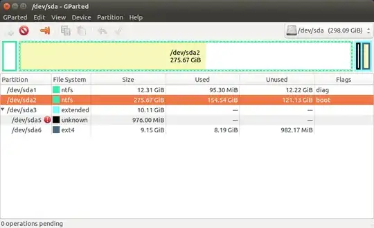

Screenshot

I can see that you don't have an UEFI boot partition, but I don't like the "unknown" partition, so the easiest thing to do for you now is:
