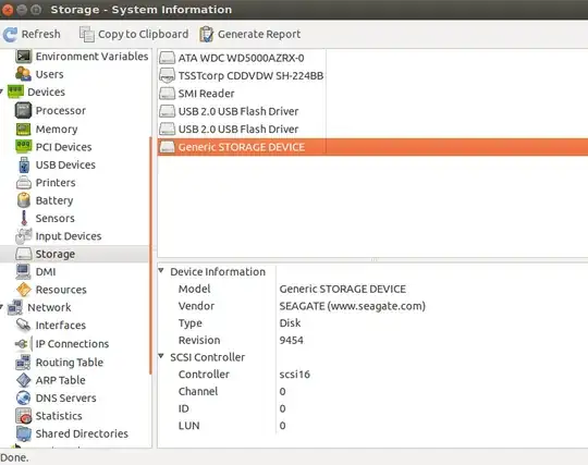

I used hardinfo to see if my mini SD card was working, as shown in the image.

  1. Looking at your syslog screenshot, there are physical errors while mounting. Is this card working in any other devices?
  2. You probably want to mount partition (/dev/sde1), not device (/dev/sde) with sudo mount... command.
You can try to list partitions with sudo fdisk /dev/sde -l, but considering the above error of read sector 0, there might be a problem, as partition table is held on sector 0.
