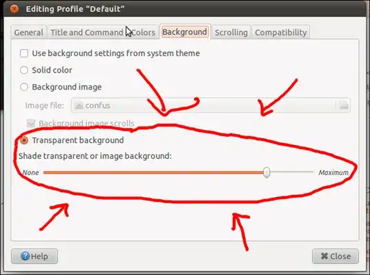

Menu: Edit -> Profile Preferences
con-f-use
  • 19,041
Did you try in Terminal - Edit -> Preferences -> Profiles -> Edit -> Background ?
