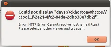

I am trying to get additional functionality from a school website that can allow multiple file uploads/downloads via drag and drop between the site's Resources folders and my personal computer via a WebDAV client, versus downloading each individual file manually. However, this feature is only officially supported for Windows and Mac, or for 3rd-party clients for those operating systems. I would like to be able to use this feature with Ubuntu 11.04.
I have already taken a look at this question, but had no luck with its answer...probably because it never asks me for my school password, and I can't find a way to input one.
If there's a way to do this using what's already installed by default, or from some other application, please let me know.
UPDATE: When I try connecting through Nautilus, I get the following error message, regardless of whether I picked WebDAV (http) or Secure WebDAV (https):
And just to reiterate, at no point does it ever ask for my password.

On Ubuntu 14.04:
1) Open Nautilus (File manager)
2) Click on 'Connect to Server'
3) As server address enter:
davs://<username>@<webdav_address>
It is important that webdav_address doesn't contain the protocol. So for example if your web url is: https://example.com/webdavand your username is alice, the corresponding address for the server will be:
davs://alice@example.com/webdav

Things have changed since the other answers on Nautilus running on later versions of Ubuntu
The acceptable connection string for WebDAV servers is like this.
dav://192.168.1.8
It'll ask for username and password.
Or if you need to specify user in the connection string itself.
dav://<username>@<address>
