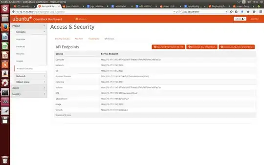

  1. So after that ceilometer is installed. But in my case it has been installed to regionOne (landscape's), not in my region. So, I fix it in that way: You need to connect to machine where you have installed ceilometer. You can find it using juju status ceilometer. My container is 0/lxc/10:
    juju ssh 0/lxc/10
To get proper enviroment for keystone and ceilometer download openstack rc file: enter image description here
on ceilometer's container run next:
    sudo nano admin-openrc.sh
And copy text from downloaded file to new file. Save it and close.
  1. Run next:
    source admin-openrc.sh
    #enter your openstack password (you can find it on your landscape monitor page)
    keystone endpoint-list
    #copy id of endpoint with uncorrect region. And remember the url.
    keystone endpoint-delete  **paste this ID**
    keystone endpoint-create --region **YOUR_REGION** --service-id ceilometer --publicurl="**CEILOMETER_URL**" --adminurl="**CEILOMETER_URL**" --internalurl="**CEILOMETER_URL**"
    5.Relogin to your dashboard. If you have made everything right you will see Resource Usage on your admin's panel and clicking "Generating report" won't go into mistake.
